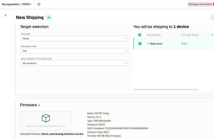

I’m facing an issue with Blynk.Air (OTA). I’m trying to update the firmware on my ESP32. I’ve done the setup correctly ,selected the correct template, set the update time, and configured it to update without any conditions. I’m also using the correct .bin firmware file.

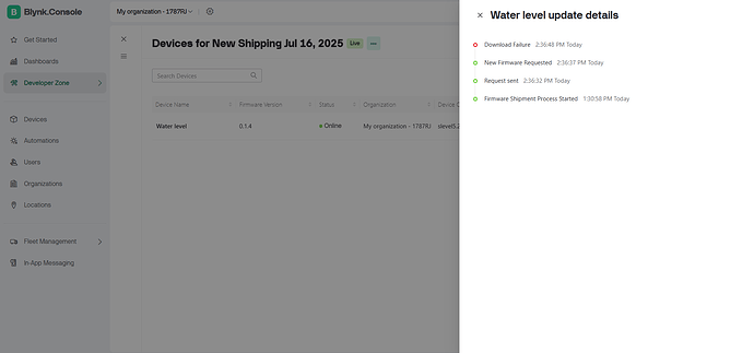

The upload process starts, but it never finishes.

What does the log say?
Hello @Ahmad_A. I checked your shipments in your acc
id 44799 - Firmware Uploaded status
id 44800 - Download Failure status
The file exists on the server, I checked. The error looks strange.
My point:
  1. Please don’t remove 44800 id firmware.
  2. Please create new same shipment with same .bin file and try run this shipment
Also very need logs from serial monitor.
Just a question, you use Blynk.Edgent, right?
