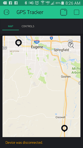

For some reason somewhere along my travel path a marker will remain at some random location. This will cause the map to remain focused on that position while the updated marker moves off the map. Hitting the lens again will scale the map to show both markers. I only want one marker. I have no idea why a second is created.

I don’t know why you get the extra marker, but you can just try clearing the map each time before placing the next one.
myMap.clear();
I’m sure that’s a waste of bandwidth, but I can’t think of anything better. I’ll take it as an interim solution. Thanks for the help.

@Slide @Pavlo - quick fix for your issue would be a change of all ‘index = 1’ to ‘index = 0’, as indexes are starting from 0, not from 1.
Yes! I just forgot it.
