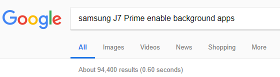

For that you will need to Google your Phone’s make and model along with the question about App permissions.
You might as well also confirm that you haven’t accidently turned off the ability for some or all Apps to keep running in the background… again Google your phone make/model for that info.
