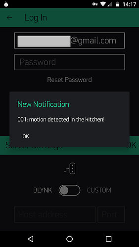

i have a project where i use the notification widget.
even after i logout from my blynk account, i still receive notifications. this is normal? i think it is not good behaviour…

also, even if i’m logged in and project is started, i do not receive any notifications if i put the app in background, or lock the screen of the phone. i have restarted app, cleared cache, reinstalled, restarted phone, etc.
