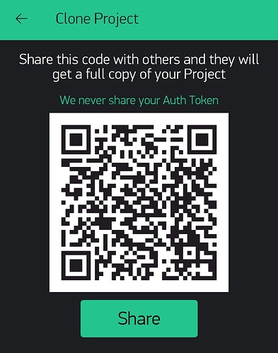

Somebody passed me a QR code so I can manage my own device, however when I try to scan it, it says I don’t have enought energy
I tried to buys some credit ( 5000 point now) and still cannot get to scan it: I get the same message!

I think the “issue” is that you don’t have enough energy for the project you are trying to import.
It’s pretty baby not worth investing too much money in this project, as the Legacy cloud servers will be turned off at some point, and the energy you’ve bought will be lost, and the project will stop working. You’d be better migrating to Blynk IoT if you are looking for a long term solution.

I understand I have to pay for the services, however I think you are missing the point: I want to use someone’s else project to test my device, but blink calculates I have not enough “energy”, and instead of telling me how much I need ( which already knows) tells me to buy more. I have tried to contact the developer but have received no feedback, which is why I’m asking in the Forum. I understand I may loose the credit on the legacy app, but that’s actually irrelevant if I cannot create the project. As it stands I cannot move forward. So what is the solution?
Try posting the QR code.
Pete
Here is the code
It requires 6,500 energy units.
Thanks Pete, yo saved my life!
Just managed to scan the code - after getting some more credit

By the way, how did you manage to find out how many point was required?
I scanned the QR code and deducted the remaining energy from the energy I had previously - then deleted the project.
