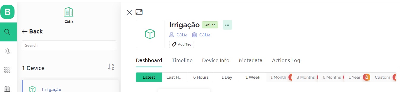

Segue:
#define BLYNK_TEMPLATE_ID "TMPLjCFDWIeX"
