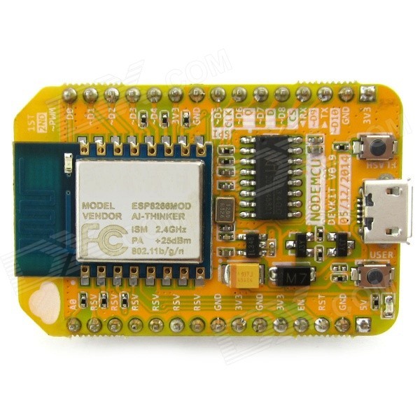

NodeMCU ESP8266 ESP-12
I have problem with this, I add Blynk library, select ESP8266 esp-12, and I use ESP8266 standalone from here:
ESP8266-ESP-12Standalone-Blynk-101
And I upload it without a problem, then it connect to my WiFi, I saw on serial monitor that is connected and have its own IP adress, I copied auth from email to code ofc.And I start blynk project with one button to for D2-GPIO4, and it wont work.And after that my router got problem and I need to restart it, I thinked that it could be router, I changed new, but same thing.I have 3 of these esp8266s.With every I got the same thing.
Maybe someone know what is the problem?
Thanks in advance
