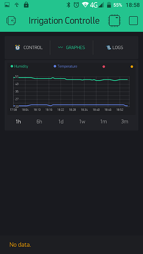

I have an error when trying to export data from the History Graph. I’m running a local server version 22.3. When try to export to CSV.
The graph shows the data I just cant export it.
Have a look at the screen shot at the bottom.

Hello. Did you configure mail.properties?
Yes. It’s configured. Have tested and have received registration emails.
Could you please check blynk.log for errors and post here?
I cant see any problems in the logs
tail blynk.log

What app version do you have? ios/android?
Android App version 2.10.0.
Can’t reproduce. No ideas what it could be. How exactly do you exporting? Via http or button in app?
Using the button in the app.
But now that I have tried I cant get to the data via HTTP either.
If I go to http://SERVER_IP:8080/TOKEN/data/v11
I get “Error getting pin data.”
Did you recently update from very old server/app?
My first version was 21.7 or something like that. Have been updating regularly.
