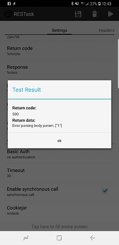

I already tried to create Tasker action with the same data for webhooks that I use for IFTTT and then use it for NFC trigger, but gives me just this error
Error parsing body param
This is not the tasker forum :stuck_out_tongue: you will get better traction there first… then we can help with the Blynk side.
Besides… can’t see anything on your screenshot to show the precise webhook data you are trying to send.
