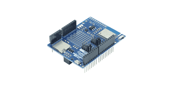

I am running with Adruino UNO with a ESP8226 Wifi Shield, DHT22, Vibration sensor, LED and Buzzer and powered direct from the laptop. The circuit has no issue, just when I added in the code for Blynk WiFi Connection, then i cant obtain the output i want.

But the power supply i am using a port from the laptop. Any suggestion from your side? Cuz the ESP 8226 wifi shield i am using is an addition top on board on the adruino.
The link of the wifi shield:
Try powering the Uno via the barrel connector. It accepts 9-20v DC
