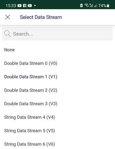

Q3. I take it that the Virtual Pins are confined to a particular Widget as below (Value Display)?
Yes. However, for value display all data streams should be available. Do you see some pin missing?
Looks correct. Do you have selected V1 in the widget settings?

Q3 - The datastreams are configured in the device template, via the web portal, and are available to all widgets in that device. The thing to look out for is that the default maximum value is 1, so if you write a value higher than that to the virtual pin it well be displayed as 1
