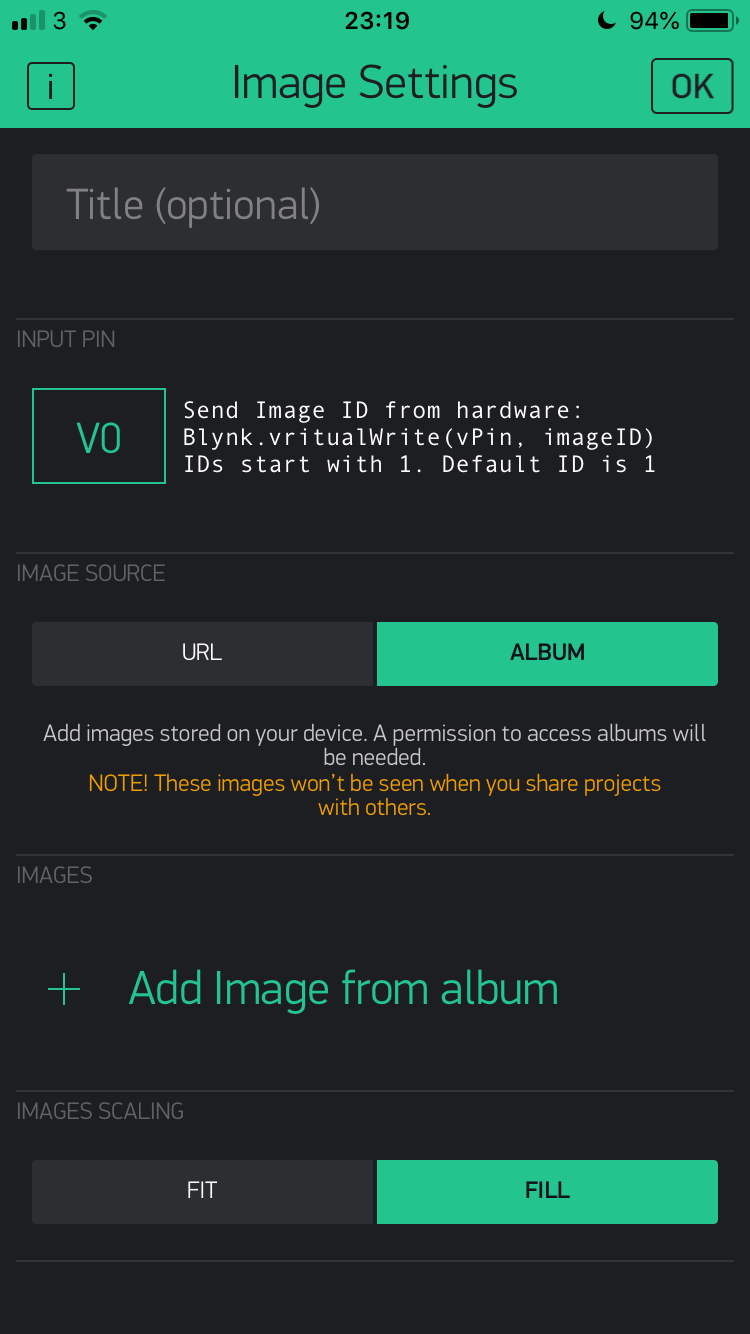

In iOS, you have the choice of URL or Album.
Choose Album and “+Add Image from Album”.
The disadvantage of doing it this way is that the image wont work if you use App Sharing, or if you open the app on another device.
It’s better to put the image in a place where it can be accessed from the internet and use the URL.

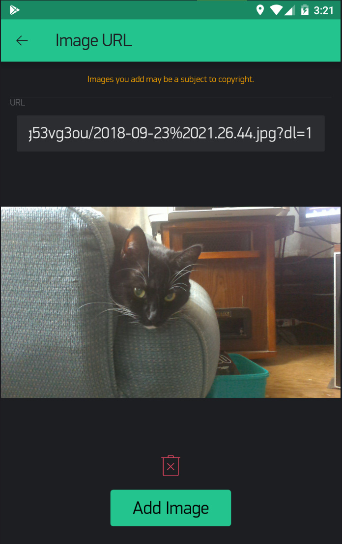

A Dropbox link works if changing the last dl=0 to dl=1
My phone automatically copies all photos I take to my Dropbox… but getting the link and file name automatically in this Blynk widget would take some magical coding :stuck_out_tongue:
