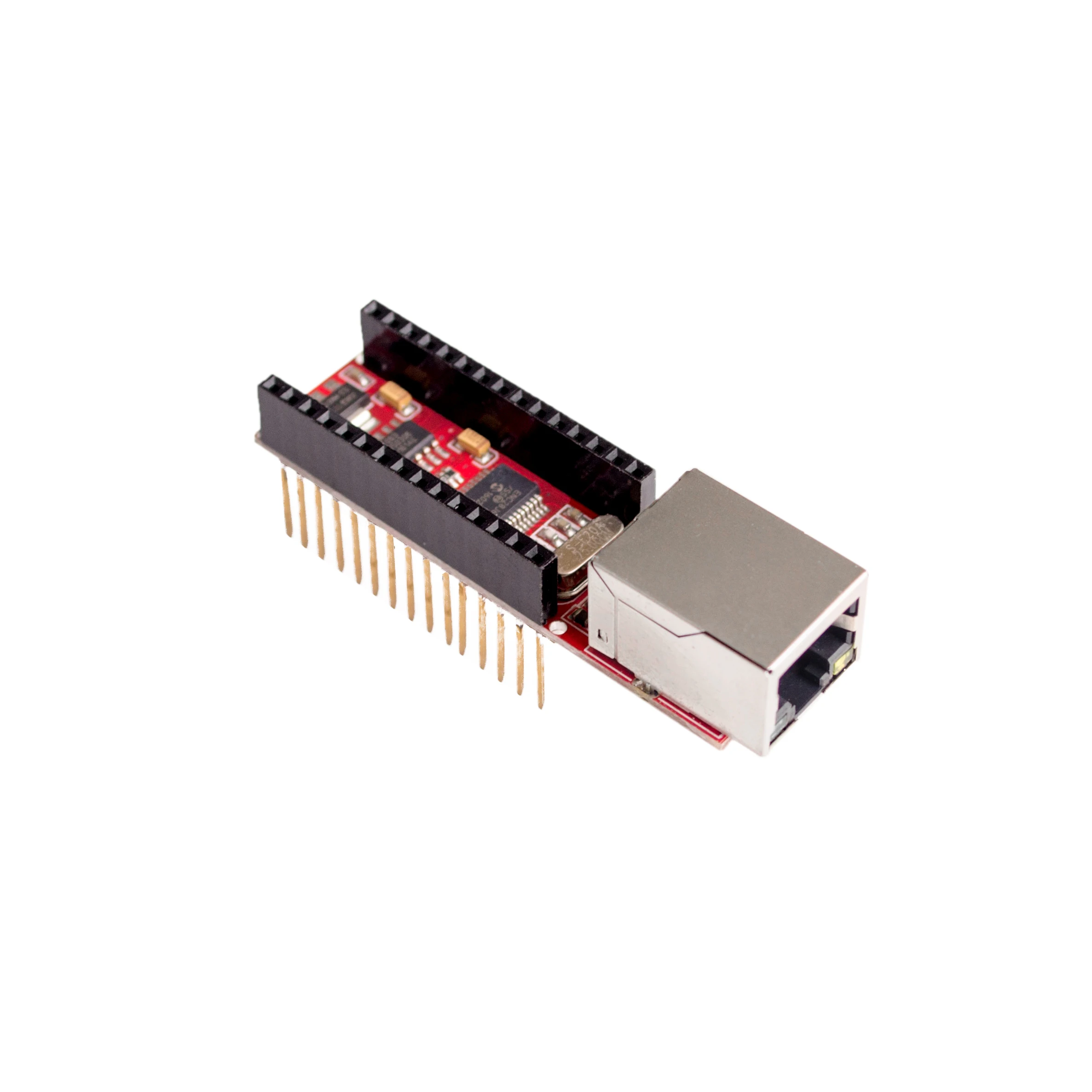

The auth is good, and the connections are good too because i’m using this shield :
Thanks for helping me.

Hi, I just realized something, the RJ45 socket is supposed to light up when connected with the cable wich wasn’t the case before. So I tried to disconnect/reconnect the arduino nano to the shield and now i can see the leds working.
But the shield is making some heat, it is not realy hot but enough to let me think it is annormal.
In addition, the card still cannot get the ip with the ENC28J60 exemple from blynk.
Are you plugging the other end of your Ethernet cable directly into the router, or are you using an Ethernet switch?
Some Ethernet shields don’t work correctly with some switches, so plugging directly into the router will eliminate that as a potential issue.
Yes my shield is plugged directly into the router
