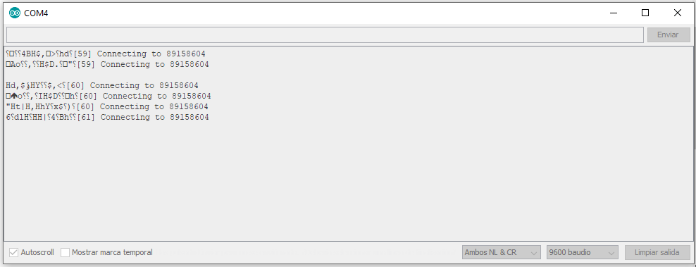

i use a NodeMCU, i changed the baud rate a 115000 and the options of tools.
This appears to me in the monitor serial.
scandone
no 89158604 found, reconnect after 1s
wifi evt: 1
STA disconnect: 201
reconnect
scandone
wifi evt: 1
STA disconnect: 201
reconnect
