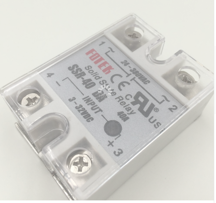

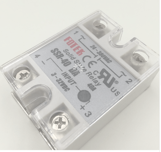

I am using WeMos DI Mini, to power 2000W heating elements via SSR (pictured below)

Just quickly, google “fotek ssr fake”
@Dave1829 Well thats a bummer, looks like I need to check the SSR when I get home. I know this doesnt mean it isnt fake, but the manual heater on/off works consistently; but if it is a good fake I guess it will work sometimes but the reliability wont be there.
Ill do some googling tonight, but do you know any reliable places to get a SSR I know will work?
It so happens my SSR from “Fotek” (or Faketek …) arrived today but it seems to work fine. Since it does work consistently right on the manual approach I’m kind of out of options. As @Costas suggest it may be good to improve the code in a general sort of way and see what that does.
As soon as I get time, I am uploading my new code with sensor readings out of the loop, and added two blynk LED widgets to track pin status on the two heater pins. That way I can know if the arduino thinks it off but the relay is keeping it on, then it should be the relay which is the problem; and I will look to replace or other solutions.
