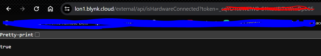

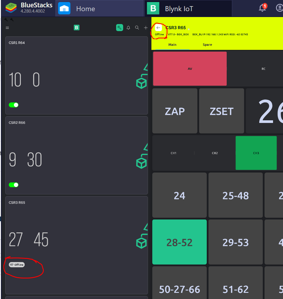

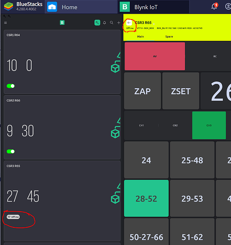

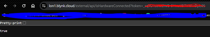

My device show Offline but the Api returns true
My device shows offline and I can’t do any command from Blynk AppUsing th api cmd on browser it reteruns true and whe I try to get some virtual Pins values it returns the realtime values from the device, this means it is connected but why from th App shows offline…

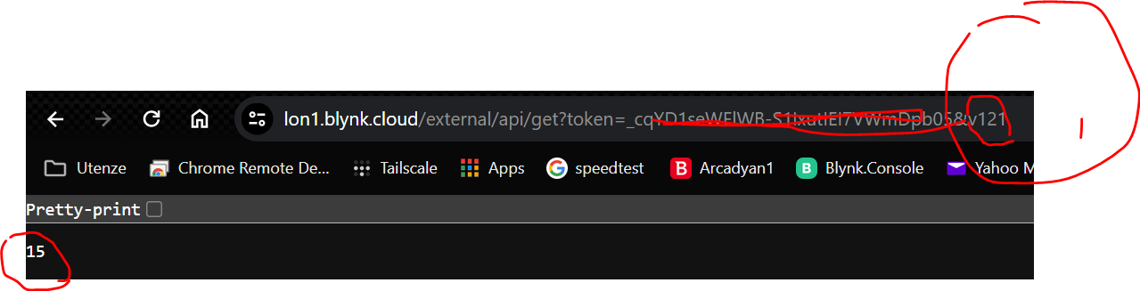

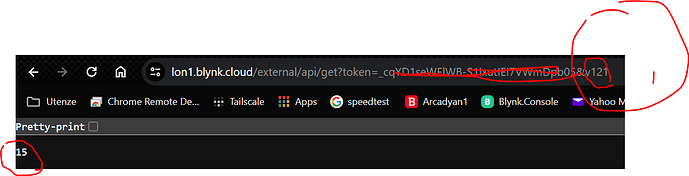

Whe I read the Live Virtual Pin I’ve created in the device that increment every 15 seconds I read it correctly…
15 the 30 then 45 …so the device is connected, why it shows offline?
When I send any command from the api http it doesn’t react, this means the ESP32 is connected in read only, it is connected and can send Vpins but can’t receive Virtual Pins commands…

Today, I changed some parameters in the active router then I rebooted it , after 10 sec as per the Logic in all the 3 devices , the devices switched to the second router and I can see all the 3 IP in the second router…
What happened is that I have only the 3rd shows offline… the other 2 devices sjows Oline as they should…
