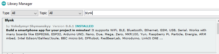

Because you are using a Blynk Legacy you need to downgrade your Blynk library to 0.6.1
this is the URL https://github.com/engineertype/MAX31855
Hi

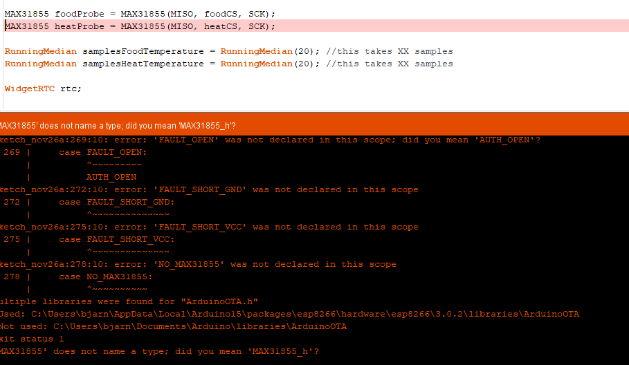

i have downgrade Blynk to 0.6.1 i still get the same error
I highly recommend you to start from scratch. Writing your own code will help you to understand how things works. also I recommend you to start using blynk IOT instead of legacy.
Your compiler appears to be using an old Adafruit MAX31855 library, rather than the one you linked to.
In-install the Adafruit library and try again.
