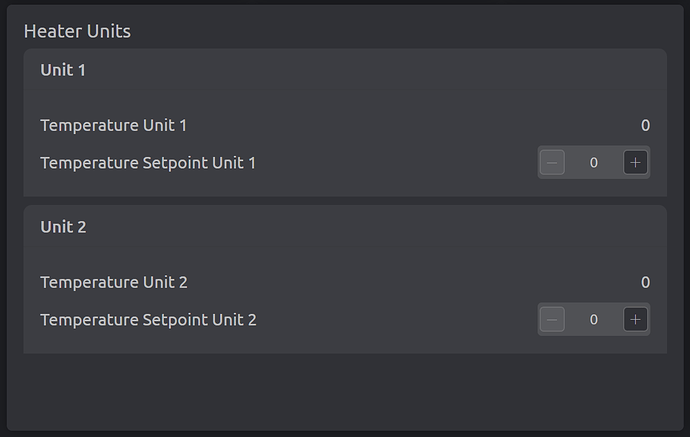

Does anyone have any advice? Here is an example of module usage on the web app. I would say this one works pretty well for what I am going for. I have up to 8 heater units, and they can each be enabled in the module view with a virtual pin value from the device. I can’t find a clean way to do this on the mobile side though. I really wish I could enable / disable tabs in the same way as modules. Here’s a quick screenshot of the example module usage on the web app when I have 2 of the 8 instances enabled
