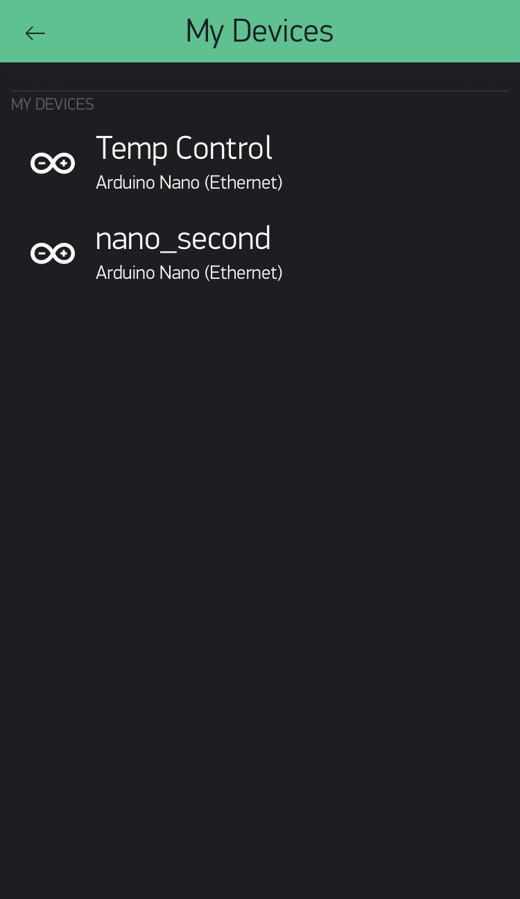

Hello, how i’m using blynk 2.26.8(1) on my ios device for temperature monitoring project.
It’s made on two arduinos nano, connecter via ethernet shield to blynk cloud.
Briefly about the project, getting data from two boards and show it in super charts on my phone.
Now i want to transfer my project to the new blynk iot platform, cause the old one is no more supported.
The question is HOW to connect two arduinos to one blynk app, and to show data from different boards in one chart like it was in old version ?
Thank you
