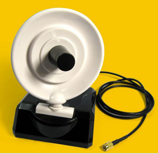

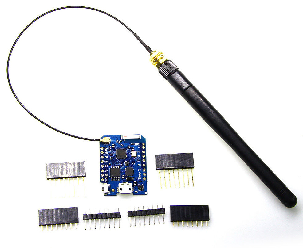

You didn’t mention the type of MCU… you could use a Wemos D1 Mini Pro with an external high gain antenna to connect to your house router.
Or even a directional one…
https://www.aliexpress.com/wholesale?catId=0&initiative_id=SB_20171019093051&SearchText=RP-SMA+2.4GHz+Wifi+directional

@Gunner - do you mean these antennas could be connect to some wifi module and allow me to connect to my home wifi? I can not believe this is possible and my home signail is reachable in the garage, or did I misunderstood you?
@helpfinder yes these https://wiki.wemos.cc/products:d1:d1_mini_pro and also ESP07’s like these https://www.ebay.com/itm/291549822984
Personally I would use WeMos.
30m is not too far for WiFi presuming most of this distance is fresh air.
Do you have a balcony facing towards the garage?
You could put your router, or a bridged router, on the balcony and you should connect fine with a decent aerial attached to the ESP.
