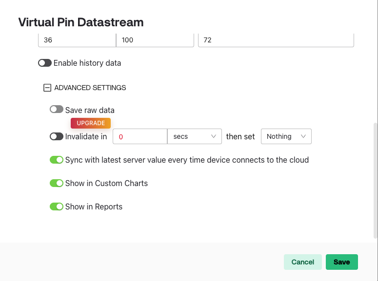

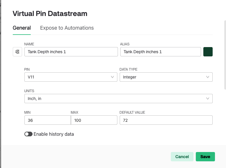

How are your datastreams configured? Post screenshots.

here is one virtual pin
we get the values on connect, BUT they could be changed AFTER connect,
WHILE RUNNING , this is a 24x7x365 day monitor application, NEVER intend to reconnect (altho it will happen due to external events)

You’ve not said which datastreams you’ve changed. You’ve provided a screenshot of V11, and posted the code relating to pins V10-V14, but you’ve not said whether V11 is one of the pins you’ve changed.
Also, you’ve said that these changed pins don’t respond to a syncAll() command, but the code you posted doesn’t contain a syncAll() command.
Can you not see how this level of vagueness on your part, along with code snippets rather than a full sketch, make it impossible to understand your issue or suggest solutions?
