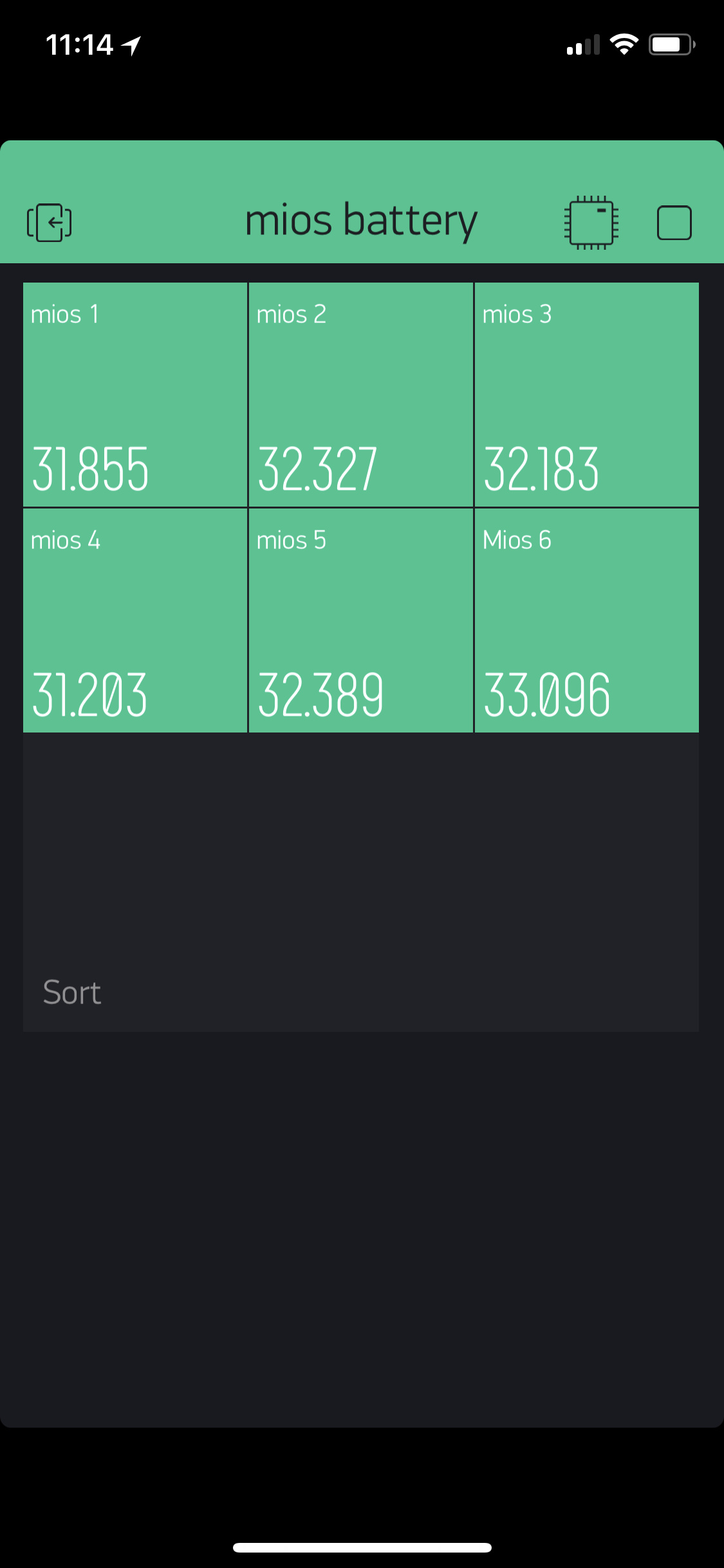

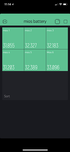

Here is my set up: I have 6 Particle Photons sending various data (6 streams- virtual pins) to Blynk. I have a device tiles installed, and each device has two super charts in them. Here is an image of my device tiles:

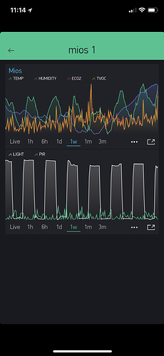

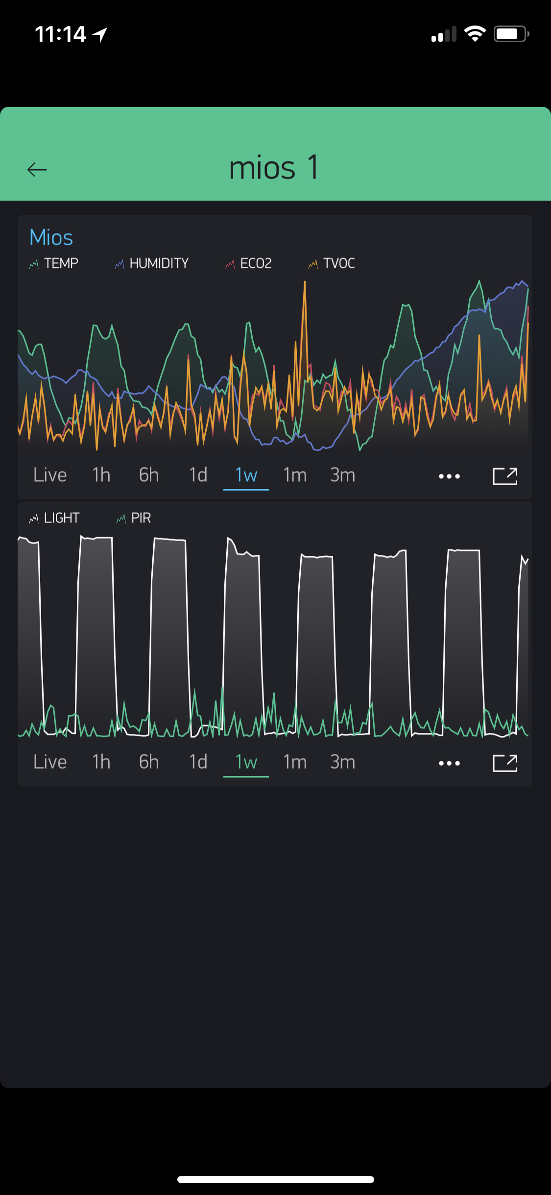

Device 1 seems to be updating the data continuously without any problems, here is what the super charts look like:

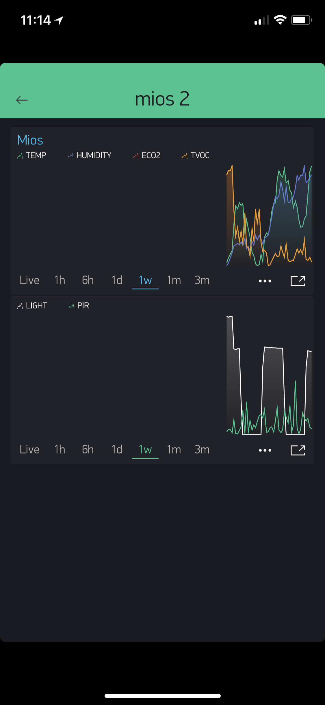

The rest of the devices are losing data (the data is being erased, all in a sudden) every couple of days, here is an example of what the rest of the devices look like:
