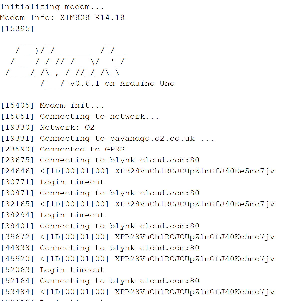

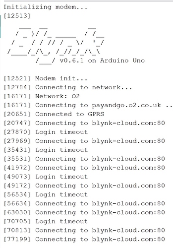

I currently have a simple project to connect Blynk Android app to an Arduino Uno via GPRS. I receive GPRS connected but then connecting to blynk-cloud.com:80 login timeout continuously. I have uploaded an image of the serial monitor too.

Thanks all
