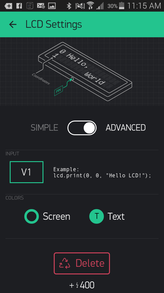

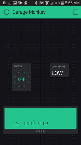

Can’t seem to get the LCD widget to run properly on my Samsung Android.
At times it seems to work but more often than not I cannot read the 1st line.
HELP!
Here’s my code
I tried the example code without the include files.
The code almost works but again, I do not receive the 1st line of text on my smartphone
All I get is “World”
This is weird. If I comment out the 2nd line of text it works although it does not clear the display.
If I then add the 2nd line back in, it displays everything.
I tried it on my IOS device, same result.
It fails to print the 1st line as well as any /pin/ request.
D0 works as an outout, D1 works and communicates as a digitalread
