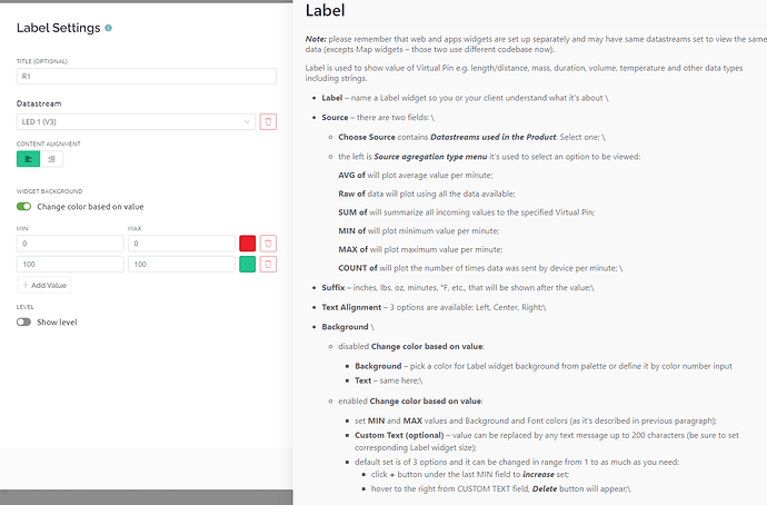

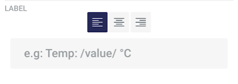

I am using pro plan, setting up new template with Label Widget. I already have a DataStream assigned to V3. On web dashboard I can set up background color based on value, in app I see no such setting. In web dashboard the text is changed based on color of background with no input from me in settings, yet in app this is the only color I am allowed to change. In web dashboard info tab calls values SUFFIX, in DataStream it is called UNITS and in the app it is called LABEL. This is all very confusing. Different terms based on where you are looking and different settings available between web and app. I am sure it is me just missing something.
Why does the label show the Vpin? This will just cause confusion as the end user does not need to know the pin assignment nor will they understand what it is or even care?
Anyway, I simply want to use a label widget. I would like the background to be RED when value is 0 and GREEN when value is 1. I would like the label to be R1. How do I accomplish this on both web and app? It does not appear possible to me to change background in app only text color.
The vPin is shown in the template view, but not in the device view. The end user will be looking at the device view.

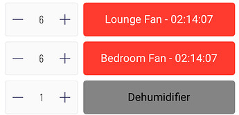

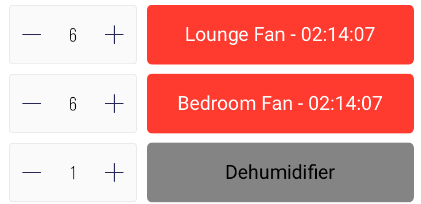

You can use the Blynk.setProperty() command in your sketch to change many of the widget properties, including the widget label (the optional title above the widget) and colour for all widget types, plus additional parameters for various other types of widgets.
For example with the styled button widgets shown below, the time remaining countdown number (the onLabel parameter) is updated once every second, and the background colour (onColor parameter) is changed according to the difference in value between internal and external humidity readings)…

I contacted Blynk for help and was told to use the label widget. If I end up using the setProperty, am I not doing the same thing as I am trying to avoid with the vled?
From Blynk
i guess there’s an easier way to display On/Off state – it’s about using a Label widget instead of LED (and you can get rid of extra code):
enable Change color based on value
setup colors and min/max DS values for their appliance
disable Show level
