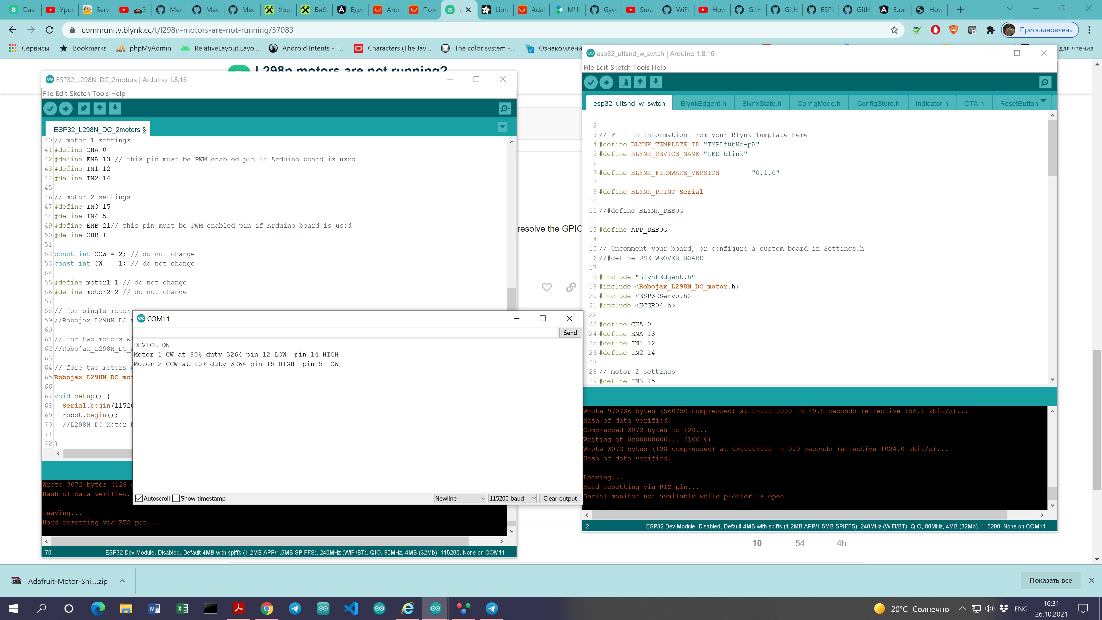

Screenshots of your serial monitor tell us very little, especially when it doesn’t show the period from booting your device.
Copy and paste the serial output, and put triple backticks around it in your post.

Arduino IDE 1.8.16 not showing more information.
Here I take monitoring information from Arduino IDE 2.0.0 Beta.11
New Line
115200 baud
9:53:28.004 -> ets Jun  8 2016 00:22:57
9:53:28.055 ->
9:53:28.058 -> rst:0x1 (POWERON_RESET),boot:0x13 (SPI_FAST_FLASH_BOOT)
9:53:28.107 -> configsip: 0, SPIWP:0xee
9:53:28.137 -> clk_drv:0x00,q_drv:0x00,d_drv:0x00,cs0_drv:0x00,hd_drv:0x00,wp_drv:0x00
9:53:28.189 -> mode:DIO, clock div:1
9:53:28.206 -> load:0x3fff0018,len:4
9:53:28.224 -> load:0x3fff001c,len:1216
9:53:28.241 -> ho 0 tail 12 room 4
9:53:28.259 -> load:0x40078000,len:10944
9:53:28.286 -> load:0x40080400,len:6388
9:53:28.304 -> entry 0x400806b4
9:53:28.322 -> Robojax.com L298N Motor Library
9:53:28.471 -> Dual Motor Demo
9:53:28.488 -> [311]
9:53:28.648 ->     ___  __          __
9:53:28.691 ->    / _ )/ /_ _____  / /__
9:53:28.742 ->   / _  / / // / _ \/  '_/
9:53:28.753 ->  /____/_/\_, /_//_/_/\_\
9:53:28.772 ->         /___/ v1.0.1 on ESP32
9:53:28.820 ->
9:53:28.820 -> [312] --------------------------
9:53:28.856 -> [315] Product:  LED blink
9:53:28.875 -> [317] Hardware: 1.0.0
9:53:28.908 -> [319] Firmware: 0.1.0 (build Oct 26 2021 16:14:53)
9:53:28.975 -> [324] Token:    ...dBnc
9:53:29.008 -> [326] Device:   ESP32 @ 240MHz
9:53:29.056 -> [329] MAC:      F0:08:D1:D3:46:D4
9:53:29.105 -> [332] Flash:    4096K
9:53:29.126 -> [334] ESP sdk:  v3.3.5-1-g85c43024c
9:53:29.175 -> [337] Chip rev: 1
9:53:29.209 -> [339] Free mem: 277192
9:53:29.256 -> [341] --------------------------
9:53:29.308 -> [344] INIT => CONNECTING_NET
9:53:29.357 -> [346] Connecting to WiFi: UGE_MAX
9:53:29.407 -> [2700] Using Dynamic IP: 192.168.41.52
9:53:31.144 -> [2701] CONNECTING_NET => CONNECTING_CLOUD
9:53:31.224 -> [2710] Connecting to blynk.cloud:443
9:53:31.325 -> [5156] Certificate OK
9:53:33.545 -> [5459] Ready (ping: 301ms).
9:53:33.892 -> [5596] CONNECTING_CLOUD => RUNNING
9:53:34.051 -> DEVICE OFF
9:53:34.225 -> Motor 1 CW at 80% duty 3264 pin 12 LOW  pin 14 HIGH
9:53:47.335 -> Motor 2 CCW at 80% duty 3264 pin 15 HIGH  pin 5 LOW
9:53:47.434 -> Motor 1 Braked
9:53:52.556 -> Motor 2 Braked
9:53:52.620 -> DEVICE ON
9:53:55.383 -> DEVICE OFF
9:53:59.523 -> Motor 1 CW at 80% duty 3264 pin 12 LOW  pin 14 HIGH
9:54:01.333 -> Motor 2 CCW at 80% duty 3264 pin 15 HIGH  pin 5 LOW
9:54:01.406 -> Motor 1 Braked
9:54:04.227 -> Motor 2 Braked
9:54:04.259 ->
Hey GUYS,
Thank you for your advice. I used code from another guys from this forum.
Please close this subject.
if someone needs my help on L298N.
