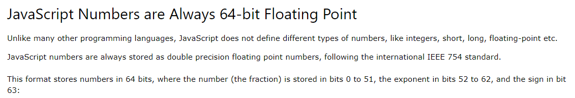

I don’t think this issue has as much to do with Blynk as it does with how JS handles values… thus I changed your topic description.
Blynk tends to use Strings for all vPin data, whereas I think JS uses something different as a common variable type… still learning
https://www.w3schools.com/js/js_numbers.asp
I’m sending a string, and I checked the JS library and it is not doing anything weird so the string shouldn’t be rounded. Probably is on server/app side.
There is not a common variable type ![]()
THere are numbers, strings, objects,…and so on.
Yeah, the types are: number, string, object, boolean, array,…
And I’m sending a string, so it’s weird to have it rounded.
And the JS library seems to just concatenate an array not manipulating the input (my string), so I suspect it is on server/app side.
