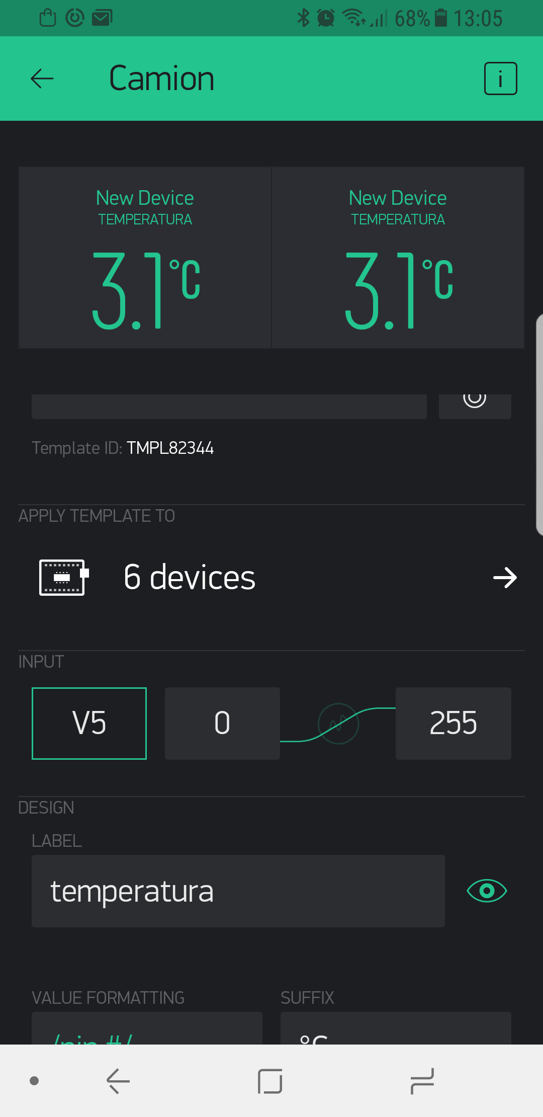

I created two vpins (V0, temperature) and (V5, temperature).
case 1: I assigned V0 has vpin in tile view and inside tile for gouge.
case 2: I assigned V5 has vpin in tile view and V0 inside tile for gouge.
In any case I get the same result.
