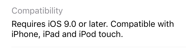

The Blynk app in the App Store says:
So I guess that’s where your problem lies.
Ok thanks, I guess I missed that. Would’ve been nice if I could have given a use to an old device but I totally understand that there’s no reason for the developers to put time into making this program work on every device.
