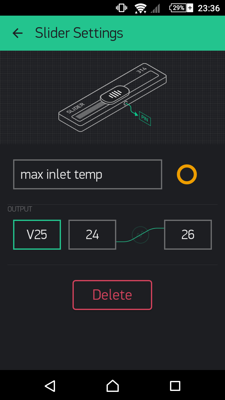

Could you please post slider settings.
Just ckecked - works for me. Does slider shows 24, 25, 26 values when you drag it?
i just deleted and re-added it…
the slider shows 23, 24, 25, 26, 27, 28 values
And you get 0 on hardware?

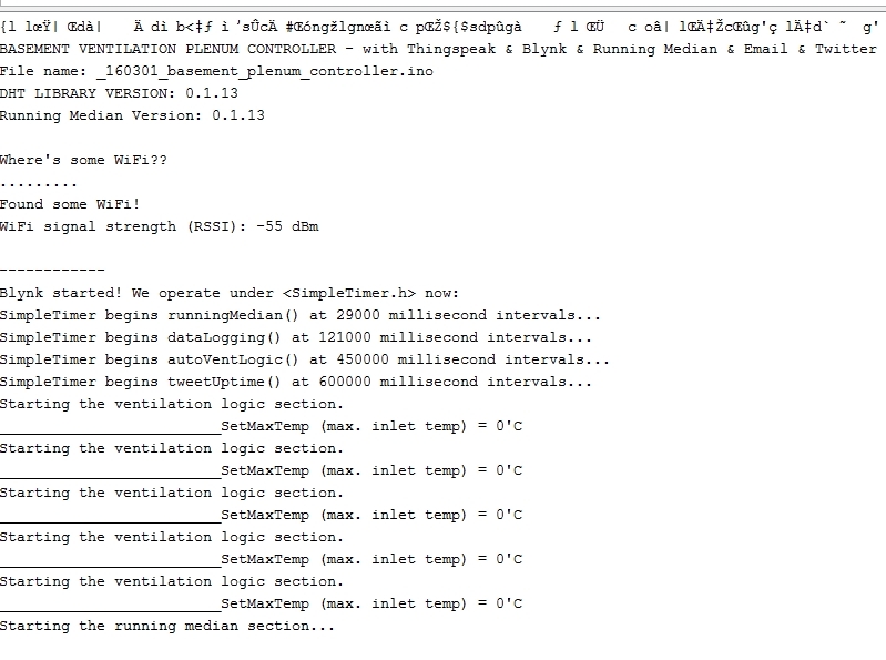

This message is not same as in code snippet you gave above.
that is the message when the autoVentLogic() runs:

logging is disabled:
//#define BLYNK_PRINT Serial
//#define BLYNK_DEBUG
i’m resetting my phone, and ESP module…
see what that does…
