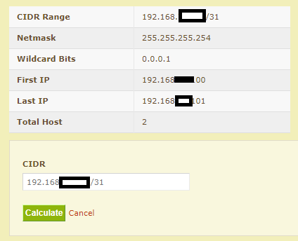

I have tried this: allowed.administrator.ips=192.168.xxx.xxx/31.
Firewall Windows: 9443->9443 Server.
Unless you really know what you are doing, stay away from /31 subnets!
You know you can’t use “xxx” right? Try something like 192.168.1.0/24 instead (255.255.255.0). Also, it’s your router that should forward the connection, not the Windows firewall (assuming you don’t get your internet thru that machine?).
