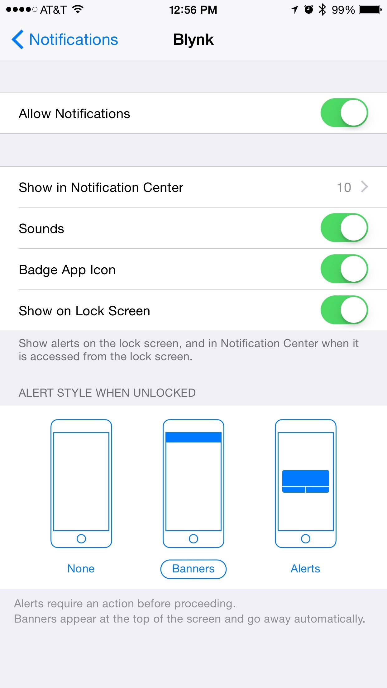

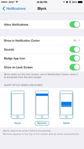

Please make a screenshot of your notifications settings, describe how you send them(code), describe your hardware set up.
We’ll start from there
This is all just a test playground…
iOS, Arduino Uno, SeeedStudio Ethernet Shield V2.0
I have 3 LEDs, 2 PWM LEDs, 4 Relays, a DHT11 Temp sensor, and I have the receiving end of a wireless doorbeel attached to my arduino’s pin 19. See doorBell function.
Thanks for looking.
