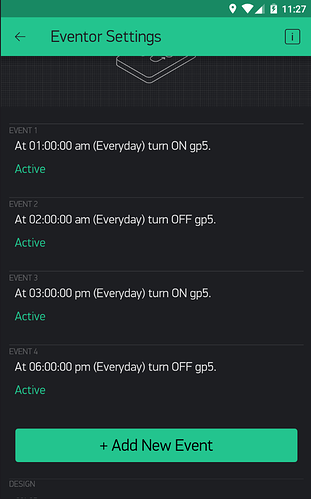

What I need is to switch pin 5 on for 1 hour AM and 3 hours pm. each day, the example shown are very complicated for such a simple task, I am using the timer wiget but i can only set once per day.
The board is wemos my project works this is an addition for my central heating control.

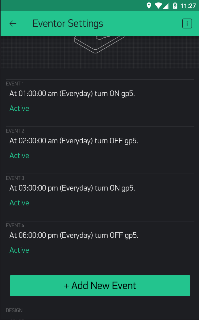

The “Eventor” should be fairly straightforward to use. Figure out your “events” in the order you want, and put the blocks together.
Simply do something like this… only with your desired times and pins.
