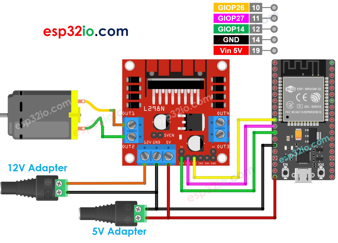

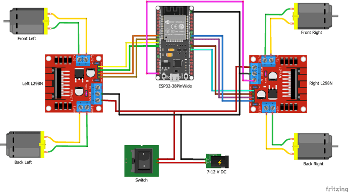

here is scheme of my connection (pins of esp32 are different).

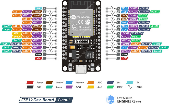

my esp32 pins structure aslo uploaded
Sounds like the 5v output from your motor driver board is not very well regulated.
The l298n 5v is not an output, it’s an input that used to Supply power for the switching logic circuitry inside L298N IC.
Thanks for quick respond,.
Pete, how can I regulate it?
If you have the 5v jumper in place then the 5v terminal can be used as a 5v 0.5A supply, but I’m guessing that there is a fair bit of noise on that supply.
The module has an on-board 78M05 5V regulator from STMicroelectronics. It can be enabled or disabled through a jumper.
When this jumper is in place, the 5V regulator is enabled, supplying logic power supply(Vss) from the motor power supply(Vs). In this case, 5V input terminal acts as an output pin and delivers 5V 0.5A. You can use it to power up the Arduino or other circuitry that requires 5V power supply.
When the jumper is removed, the 5V regulator gets disabled and we have to supply 5 Volts separately through 5 Volt input terminal.

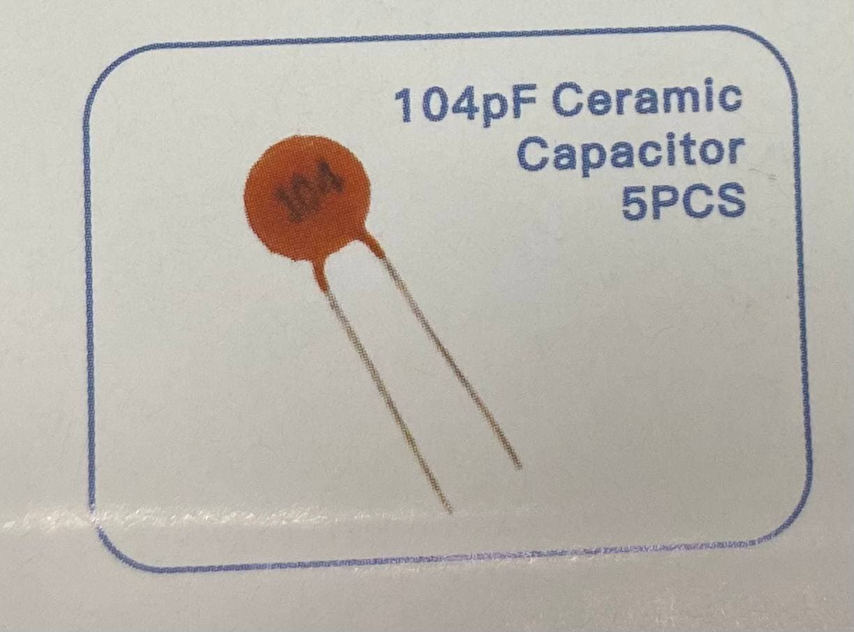

You could try a suitable capacitor as close as possible to the ESP32’s supply pins.

Have you tried to power the esp32 using a separate power supply ?
Something like this
No I have not tried yet.
Pete, I got what is capacitor it self, thanks for google.

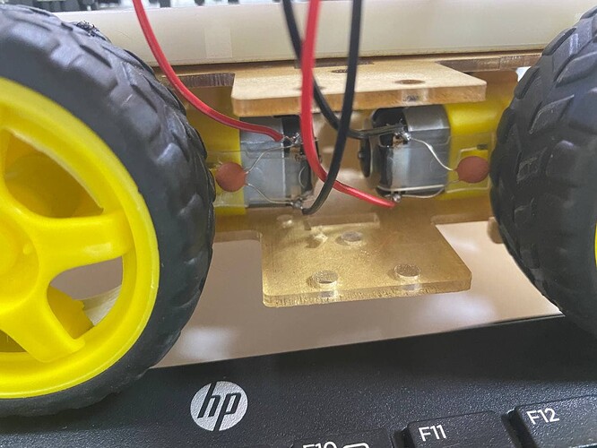

I used this one for my motors, because some russian guy on youtube told that if I attach it to motor it will not give a sound when there is low volt.
and I used it like this:
The wiring on those motors looks very dodgy to me!
