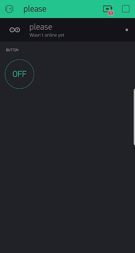

  2. On my phone:
    Screenshot

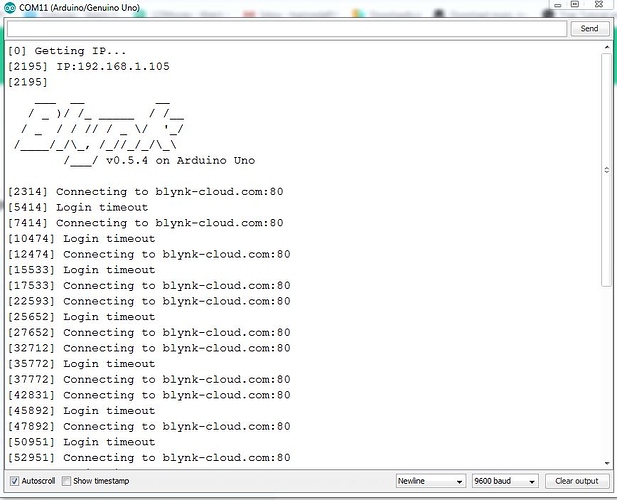

  3. Serial Monitor on Arduino IDE is:
    Serial Debug

And on the note of the auth code… double check that you are using the exact one from your App, refresh it and try again, and confirm that your Ethernet shield is actually transmitting to the internet (try other Ethernet test scripts for Arduino)… otherwise I can not think of any other reason it is not working.
