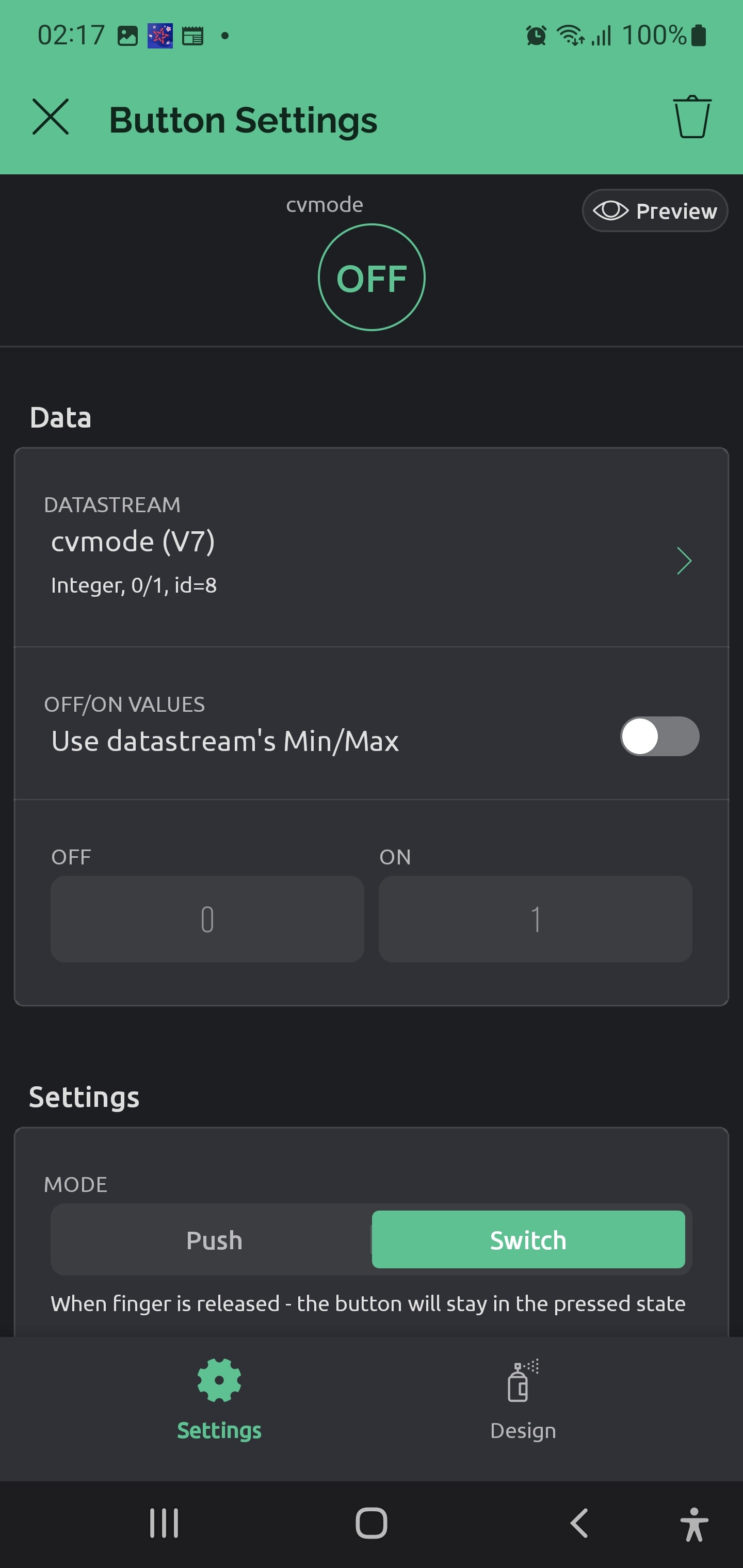

Can you post screenshots of how you’ve set-up your switch and slider widgets?
yes, here is my setup
You provided a screenshot of your mobile dashboard, but when I asked for details of how you’ve configured these widgets you’ve provided a screenshot of the web dashboard widgets.
I’m sorry. they are exactly the same
Okay, there’s a few things wrong…
