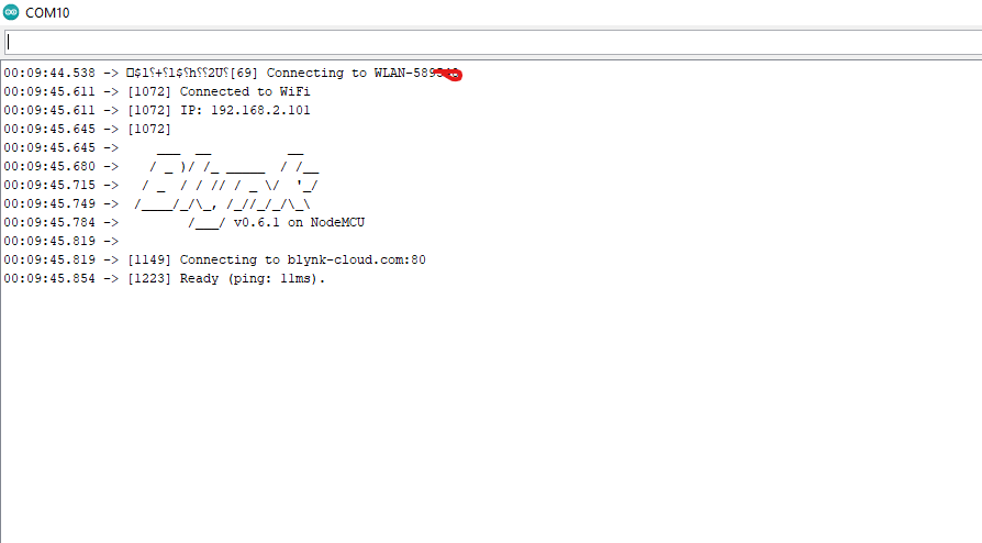

I tried from my Wife’s Smartphone to connect (new Account, new Projekt), I got an IP Adresse for my Datastream (I see in Arduino Serial Monitor), but these can not open. And come no Data thru. In App write: No Data yet…

Auth. Token ist OK. Pin setting OK.
What is Wrong? Why see I nothing?
There is a Max6675 Sensor, what work well in other Setting.
Impossible to say without seeing your code.

@balolevi please edit your post, using the pencil icon at the bottom, and add triple backticks at the beginning and end of your code so that it displays correctly.
I did it
Okay, so you’re setting up your MAX6675 object, which seems to be called thermocouple, here:
And three float variables to hold the temperature readings in Celsius, Fahrenheit and Kelvin…
But you are never taking a temperature reading, or sending the result of that reading to Blynk.
You appear to have decided to create a new variable called C but you’ve not understood how to do that correctly, as the variable you created is actually called type
I’d suggest that you go back to the original code and try to understand it better.
I’d also stay away from using Blynk widgets to trigger the readings (avoid BLYNK_READ) and instead use a timer to call the routine which takes the readings. Printing those readings to your serial monitor is also a good move, as it allows you to know that your sensor is actually working correctly.
