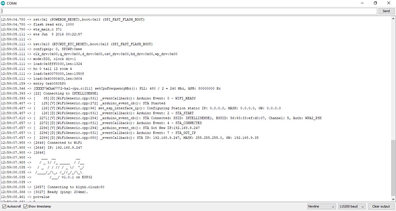

I am getting error in arduino IDE installed as windows app for ESP32 board. The error message mentions <E (246) spi_flash: Detected size(4096k) smaller than the size in the binary image header(8192k). Probe failed >

error mssg is below

Rebootingβ¦
11:51:48.618 β ets Jun 8 2016 00:22:57
11:51:48.618 β
11:51:48.618 β rst:0xc (SW_CPU_RESET),boot:0x13 (SPI_FAST_FLASH_BOOT)
11:51:48.618 β configsip: 0, SPIWP:0xee
11:51:48.618 β clk_drv:0x00,q_drv:0x00,d_drv:0x00,cs0_drv:0x00,hd_drv:0x00,wp_drv:0x00
11:51:48.665 β mode:DIO, clock div:1
11:51:48.665 β load:0x3fff0030,len:1324
11:51:48.665 β ho 0 tail 12 room 4
11:51:48.665 β load:0x40078000,len:13508
11:51:48.665 β load:0x40080400,len:3604
11:51:48.665 β entry 0x400805f0
11:51:48.854 β E (246) spi_flash: Detected size(4096k) smaller than the size in the binary image header(8192k). Probe failed.
11:51:48.901 β
11:51:48.901 β assert failed: do_core_init startup.c:298 (flash_ret == ESP_OK)
11:51:48.901 β
11:51:48.901 β
11:51:48.901 β Backtrace:0x4008307d:0x3ffe3aa00x4008b305:0x3ffe3ac0 0x4009052d:0x3ffe3ae0 0x400e13d6:0x3ffe3c10 0x40082912:0x3ffe3c40 0x40079202:0x3ffe3c90 |<-CORRUPTED
11:51:48.901 β
11:51:48.901 β
11:51:48.901 β
11:51:48.901 β
11:51:48.901 β ELF file SHA256: 0000000000000000
11:51:48.901 β
11:51:48.901 β Rebootingβ¦
11:51:48.901 β ets Jun 8 2016 00:22:57
11:51:48.901 β
11:51:48.901 β rst:0xc (SW_CPU_RESET),boot:0x13 (SPI_FAST_FLASH_BOOT)
11:51:48.901 β configsip: 0, SPIWP:0xee
11:51:48.901 β clk_drv:0x00,q_drv:0x00,d_drv:0x00,cs0_drv:0x00,hd_drv:0x00,wp_drv:0x00
11:51:48.901 β mode:DIO, clock div:1
11:51:48.948 β load:0x3fff0030,len:1324
11:51:48.948 β ho 0 tail 12 room 4
11:51:48.948 β load:0x40078000,len:13508
11:51:48.948 β load:0x40080400,len:3604
11:51:48.948 β entry 0x400805f0
11:51:49.137 β E (246) spi_flash: Detected size(4096k) smaller than the size in the binary image header(8192k). Probe failed.
11:51:49.184 β
11:51:49.184 β assert failed: do_core_init startup.c:298 (flash_ret == ESP_OK)
11:51:49.184 β
11:51:49.184 β
11:51:49.184 β Backtrace:0x4008307d:0x3ffe3aa00x4008b305:0x3ffe3ac0 0x4009052d:0x3ffe3ae0 0x400e13d6:0x3ffe3c10 0x40082912:0x3ffe3c40 0x40079202:0x3ffe3c90 |<-CORRUPTED
11:51:49.184 β
11:51:49.184 β
11:51:49.184 β
11:51:49.184 β
11:51:49.184 β ELF file SHA256: 0000000000000000
11:51:49.184 β
11:51:49.184 β Rebootingβ¦
