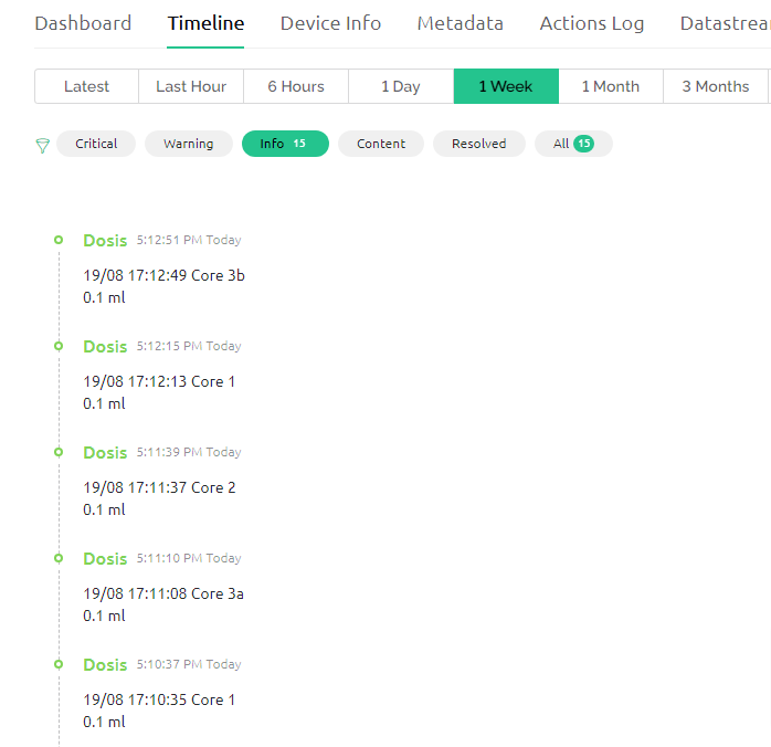

In my specific case, the device dose a chemical element every some time to an aquarium.
I was thinking in sending some data to the server like a log, with every dose done.
In that way, if the user have some way to see that log on the web console, just seeing the not listed doses, you can determine what wasn’t dosed because of the offline (not working) period.
Events are what you should use then.

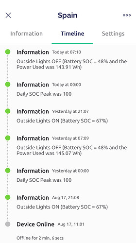

This is how i record informational events relating to my solar lighting…

Do you know if there is any way to keep in events just the last 100 records?
When the events reach the 100 records, it stops receiving any other event.
That’s because you’re exceeding the limits for the number of events per 24 hour period.
Yes Pete, I know the reason. And I know that you can reset the event counter on the web console.
My question is if there is any way to automatically reset the event counter or just keep the last 100 events like a FIFO logger.
No, the 100 event limit is there for a reason.
