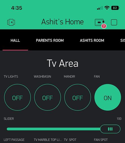

I meant this type of separation of rooms and devices
how do I achieve this with blynk iot as If I have to turn on fan of room 3 I can just go to tab and click related button in legacy app

If those are different devices then they can’t be on the same set of tabs with Blynk IoT.
I bet around this by using Node-Red, and a single device in Blynk, but that’s not a simple solution to implement.
