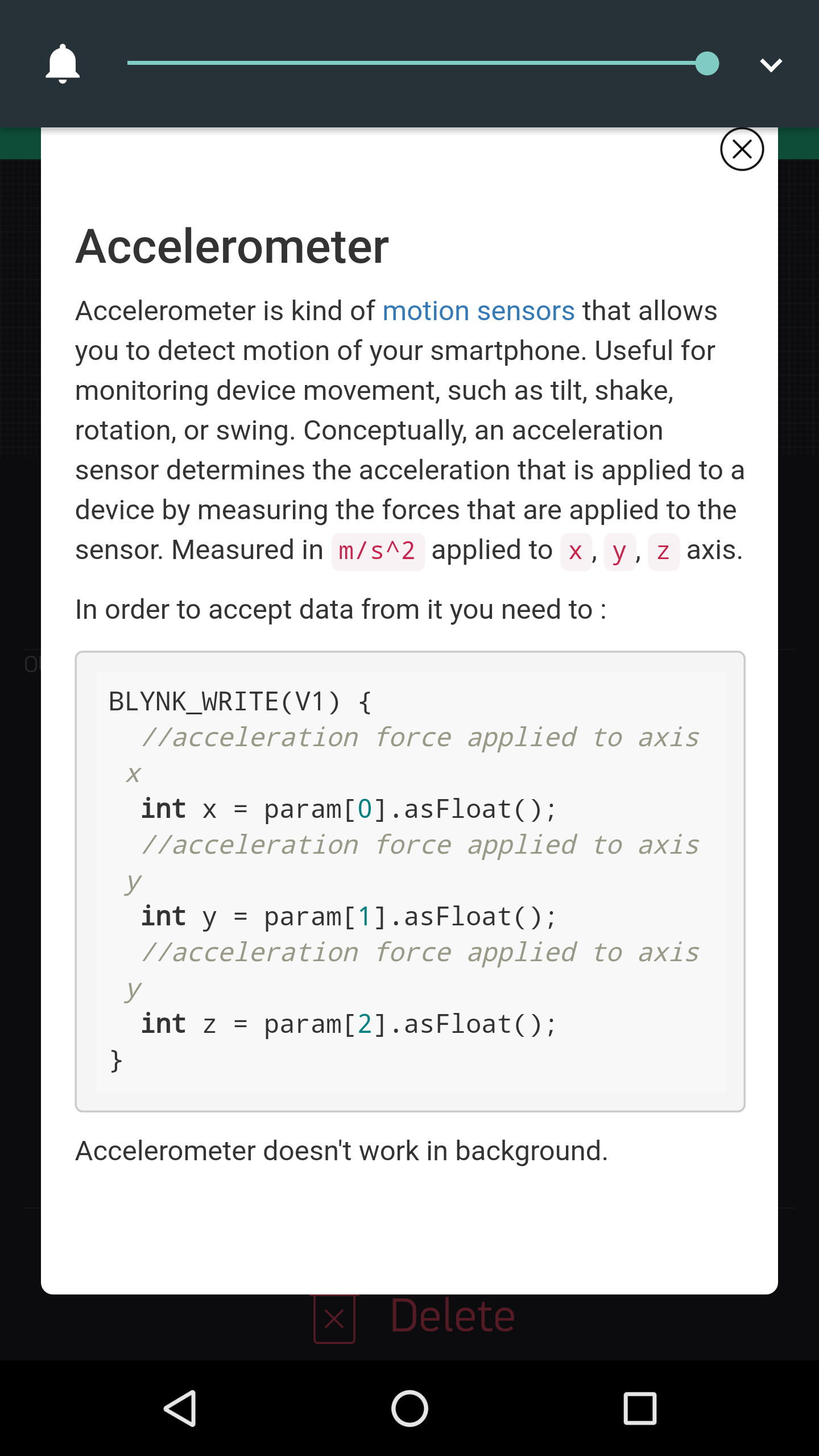

Good question… while no info in the DOCs (that I could find), you can simply click the [i] in the upper right corner of the widget (in edit mode) and see it’s built-in information.
Then with a bit of research and thinking, you could get something like this:
