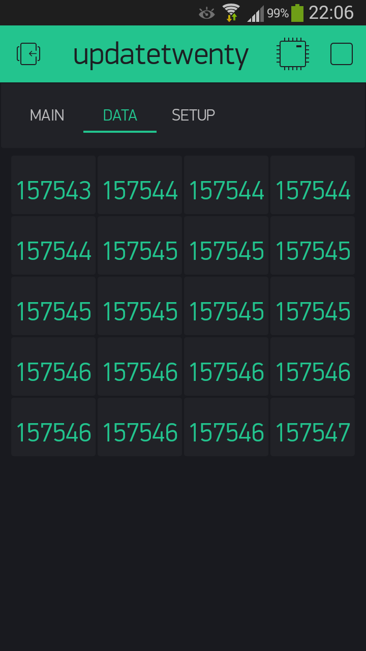

Another sample for you. Extract from the end of setup() onwards:
  timer.setInterval(2000L, updatetwenty); // 1s gives flood error
unsigned int sliderValue = 0;
void updatetwenty(){
  for(int i = 50; i < 70; i++){
    Blynk.virtualWrite(i, millis());
    delay(sliderValue); // i.e. no delay but you can test with a slider
On a decent ESP with latest Arduino ESP core gives:
