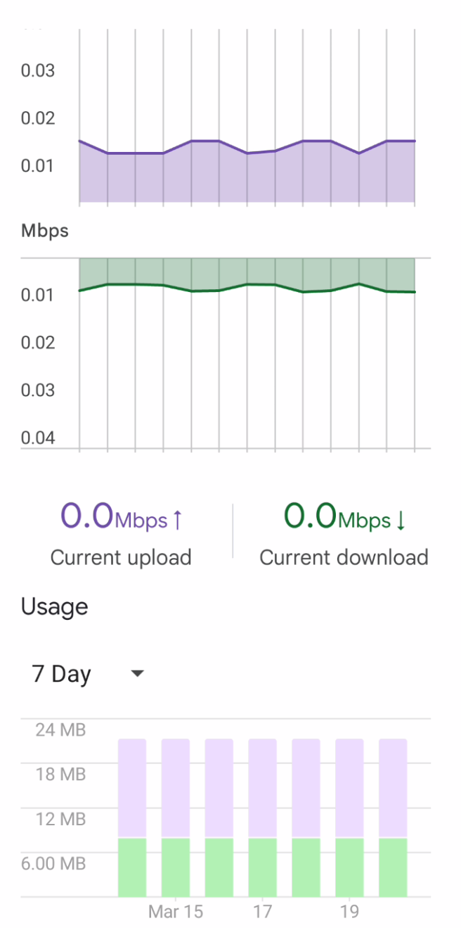

Network Data
Why?
Do you have an internet connection that charges you based on your traffic, or that limits your data in some way?

Thanks Pete,
The network consideration is more for when I have multiple devices 7+ in the same area and we have fairly “rural” internet at present that is not high bandwidth.
Also just not wanting to do it poorly if there is a better way.
