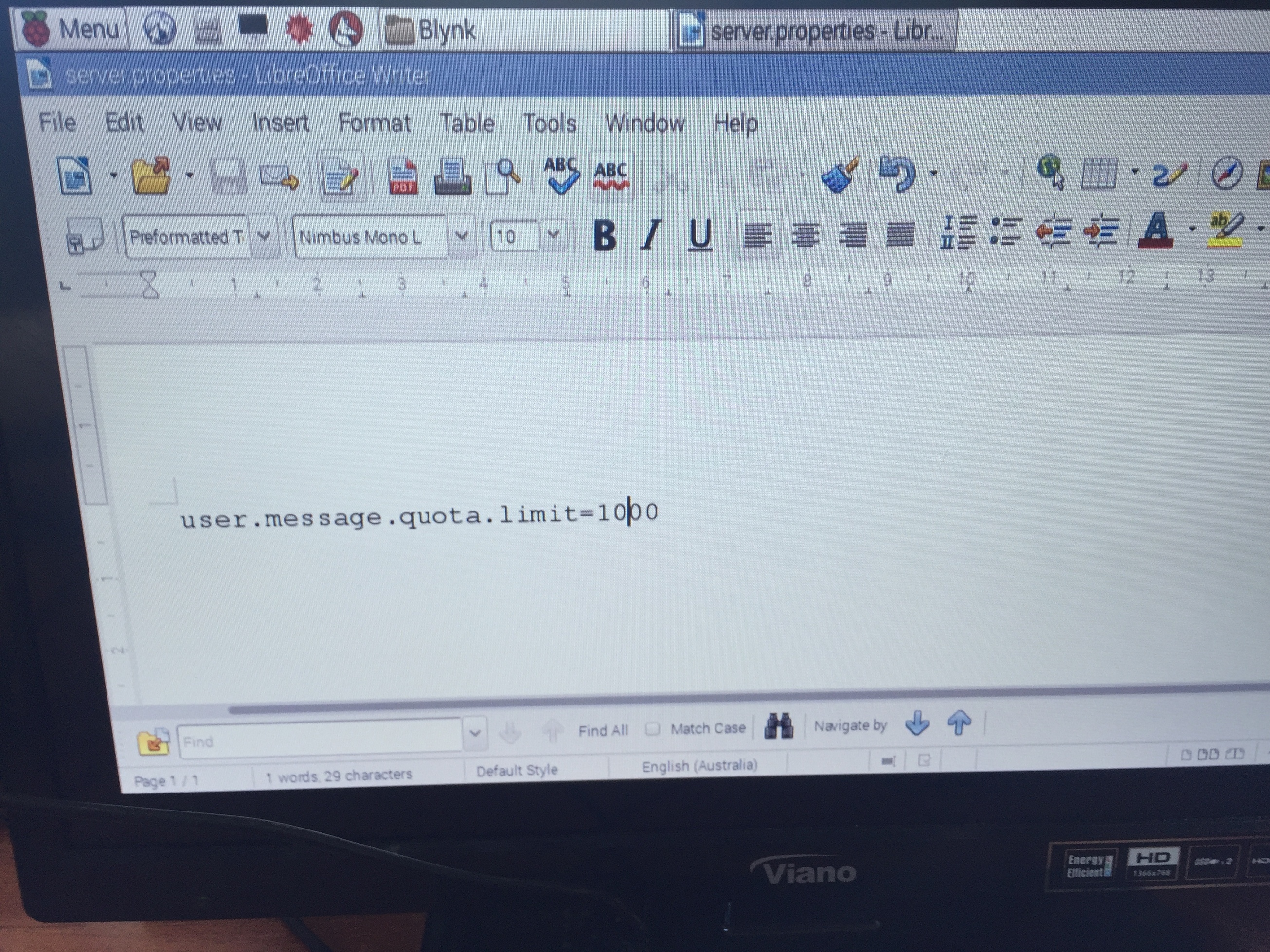

Do I just make a folder and type in this text?
Yup and then start/restart it
Here is a server.properties example: https://github.com/blynkkk/blynk-server/blob/master/server/core/src/main/resources/server.properties
Ok, I did that but can still flood the server if I stab at the buttons repeatedly.
Is that definitely the parameter that relates to flooding?
When I saved my properties file it asked if I wanted to save as ‘text’ or ‘ODF’ format. I chose text?
It is named correctly and is in the same folder as the server jar file
did you restart the server?
Yup save as text, then remove the extention (like .txt for instance).
I ended up just modifying the limit line in the example… maybe give that a go instead?
Yes, i did restart the RP.
Ill try using the whole example file
Just realised you might be best to create the file in a text editor… for a word formatter.
Download Notepad++ for Linux and use it for everything text!
EDIT: just looked it up and cant believe notepadd++ doesnt have a native linx client! check out this list for alternatives: https://itsfoss.com/notepad-alternatives-for-linux/
I used notepad++, modified the file to 1000 requests per second, saved it as server.properties and put it in the same folder that server-0.16.4.jar lives.
no joy, still can flood pretty easy. not really an issue for me but I would like to know i can get the server properties modified if i need.
I will try another editor if you think that is the issue.
