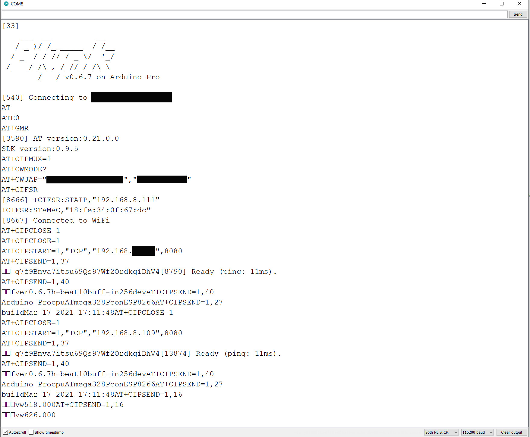

when powering the chip the light blinks for about 5 seconds and then stops. This is the message I’m getting in the serial monitor

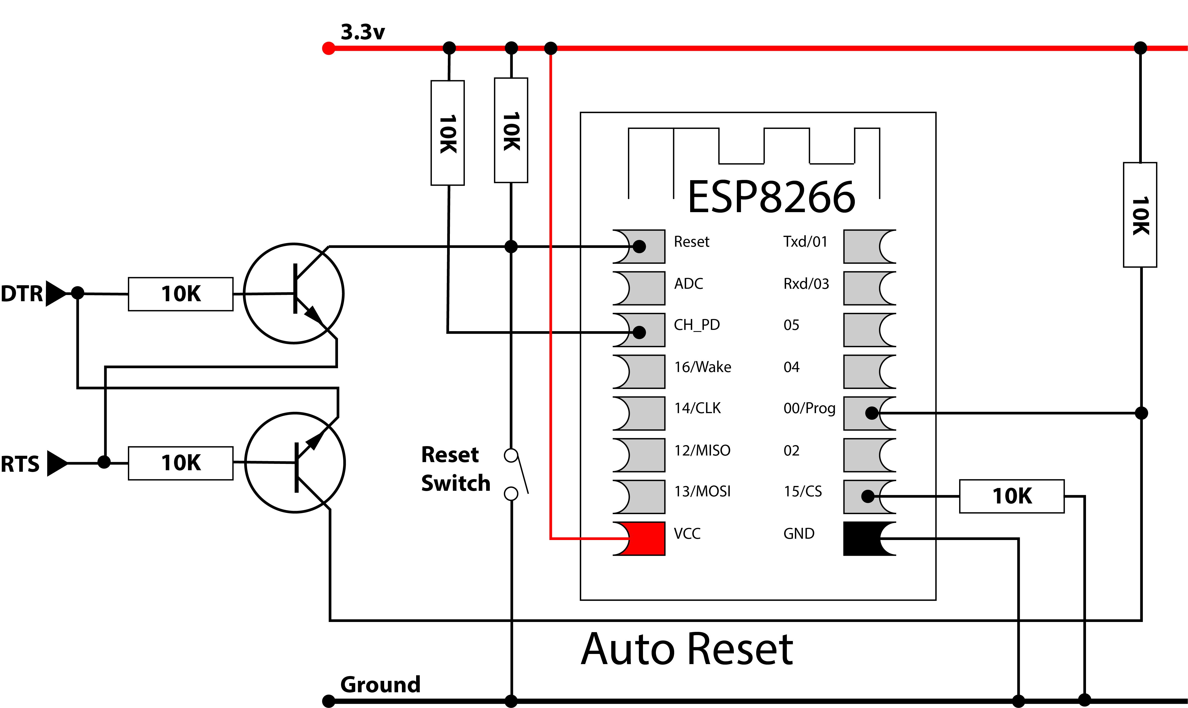

Do you have any pull-up resistors on EN and GPIO0?
This is my connection
I’m guessing that your DTR and RTS pins are being energised when the serial monitor is opened, but not when it’s closed.
Either way, it’s specific to your particular hardware, and not a Blynk related issue.
Maybe one for a more hardware specific forum?
I actually use this connection for flashing the firmware, but when I connect it to arduino RTS and DTR are not connected to anything
