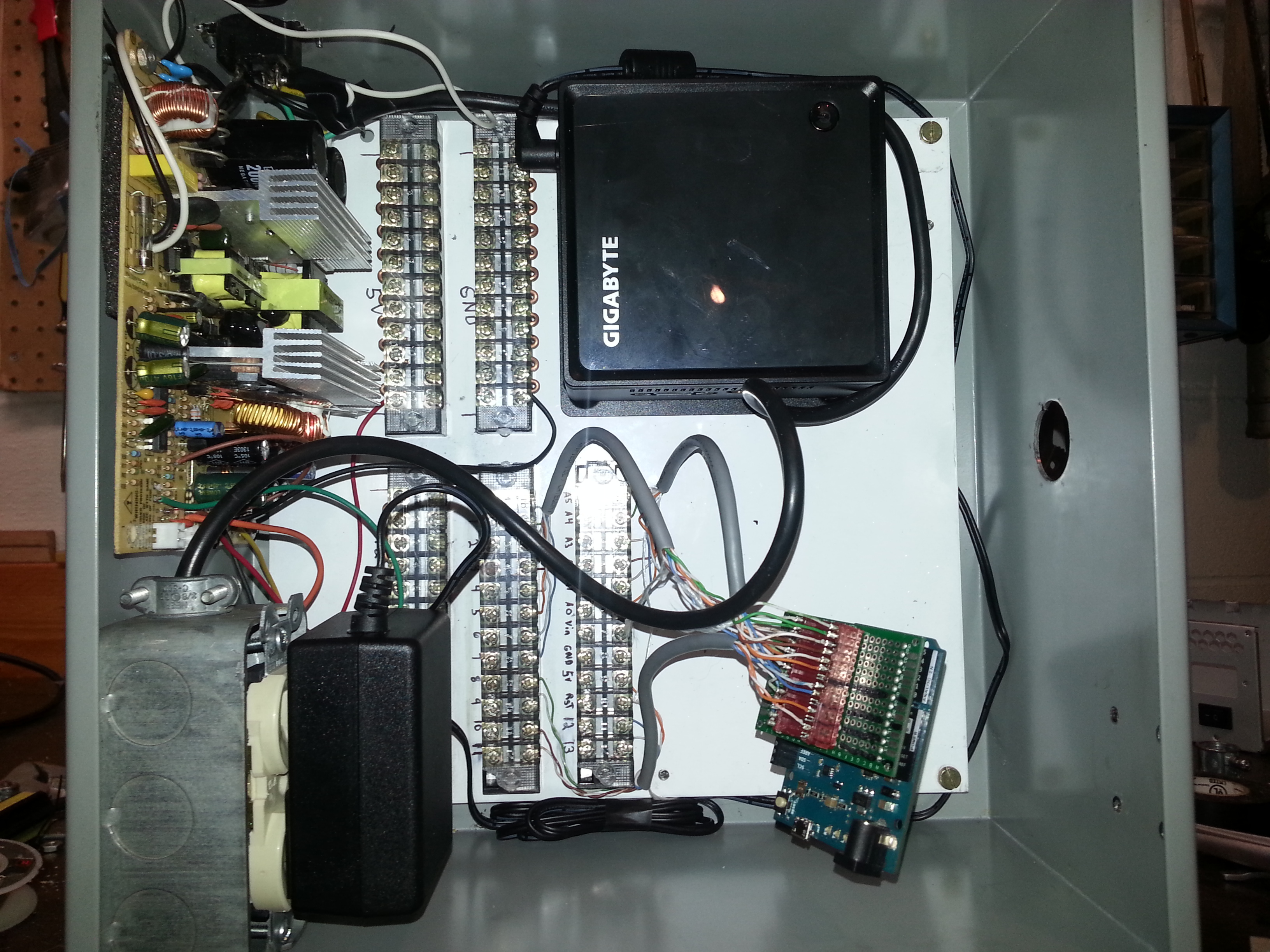

I have some additional work to do on the project, but I thought I would share the what I currently have.
The main goal of my project was to combine quite a few Ideas from others an begin to build my own “smart house”
Currently I am running everything on the local server, due to security concerns.
I will post the code once I get everything cleaned up
Sensors:
-Temperature and Humidity of main floor (control a thermostat via bypass relay)
-Basement Temperature
-Differential Pressure of furnace (how often is the furnace (forced air) running)
-Outdoor Temperature (compare Furnace DP frequency to outdoor temp)
-Photoresistors (She has a tendency to leave the lights on)
-Limit Switch (is the garage door open, another one of her tendencies)
Switches/Buttons:
-Garage Door Opener
-Thermostat (Relay to switch between OEM thermostat and arduino controlled thermostat.
Future Plans:
-I plan on updating to an Arduino Mega to incorporate more sensors and switches. With blynk the ideas are limitless.
-I have an arduino controlled incubator made in a dorm room refrigerator that I have hatched about 1000 quail out of. I would like to add mobile controls to it as well.
—Question: Is it possible to attach an HC-06 Bluetooth module to an Arduino and utilize the Blynk USB Serial COM connection to communicate?
-Add moisture sensors to plants around the house
-Add a doorbell indicator.
-Add terminal control, due to the sheer quantity of sensors and buttons that I plan to incorporate.
Any suggestions welcome.
