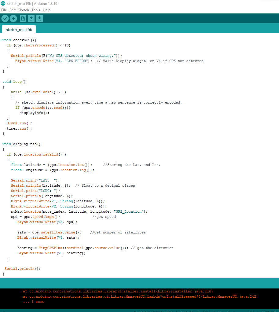

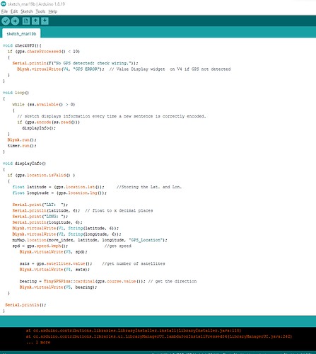

Thanks for the reply. My project does not appear on the search because it is still in developer mode. I have the NodeMCU and GPS connected. I have the code written and ive uploaded the code but I cant connect to the NodeMCU with my blynk app. I did the Blink tutorial and got that working but now im doing this project where im trying to get lat and long coordinates but it doesnt seem to be connecting. Screenshot below. Also, I changed the code to blink.cloud.com.
Since I cant get my project to connect to the blynk app, is there something wrong with the internet code? After i upload code, I go to blynk and add new device but it wont connect or it cant be found…

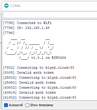

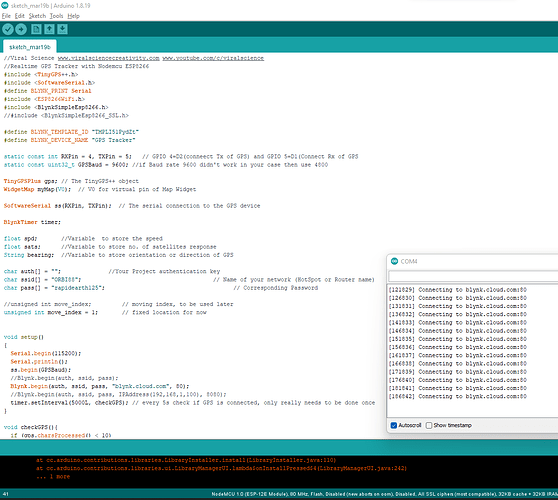

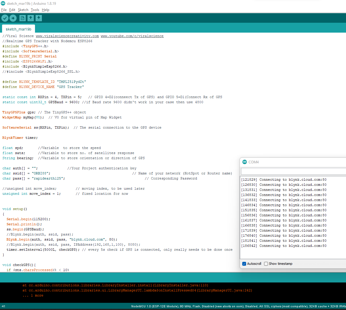

I have the and i made the change to blynk.cloud. I upload my sketch (code). I go to blynk app to add new device but I’m not getting the esp8266 wifi to appear on my phone. What else could be wrong?
If I don’t get it to connect I cant get get authorization token it is asking for.

I dont think i understood what you meant. I have no knowledge in this sorta stuff. I am trying to go by a youtube video but the individual who did this did it in the old blynk app and this code is no longer working I guess. I was hoping it would be as easy as copy and paste but it is not.
I am trying to simply get coordinates for a project I am doing that would track my dog in the back yard.
I am using a nodeMCU esp8266 and a ublox neo 6m.
If you would like to take the time and walk me through what you mean I would greatly appreciate it.
Here is what I have done so far:

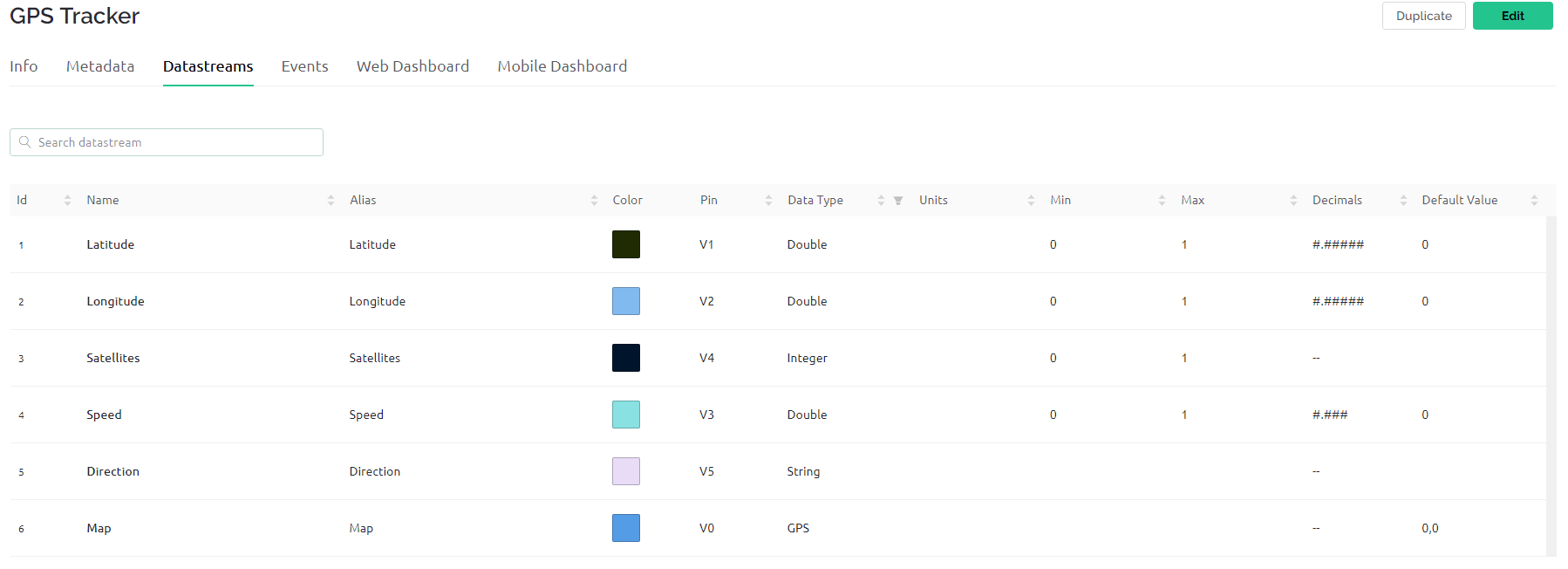

I created the template, added the data streams and saved.
I have added the code you see above in arduino 1.8.19 and uploaded it.
I have gone to the blynk app and added the widgets I need.
Now I’m trying to add new device but it is not picking up the nodeMCU wifi.
