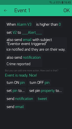

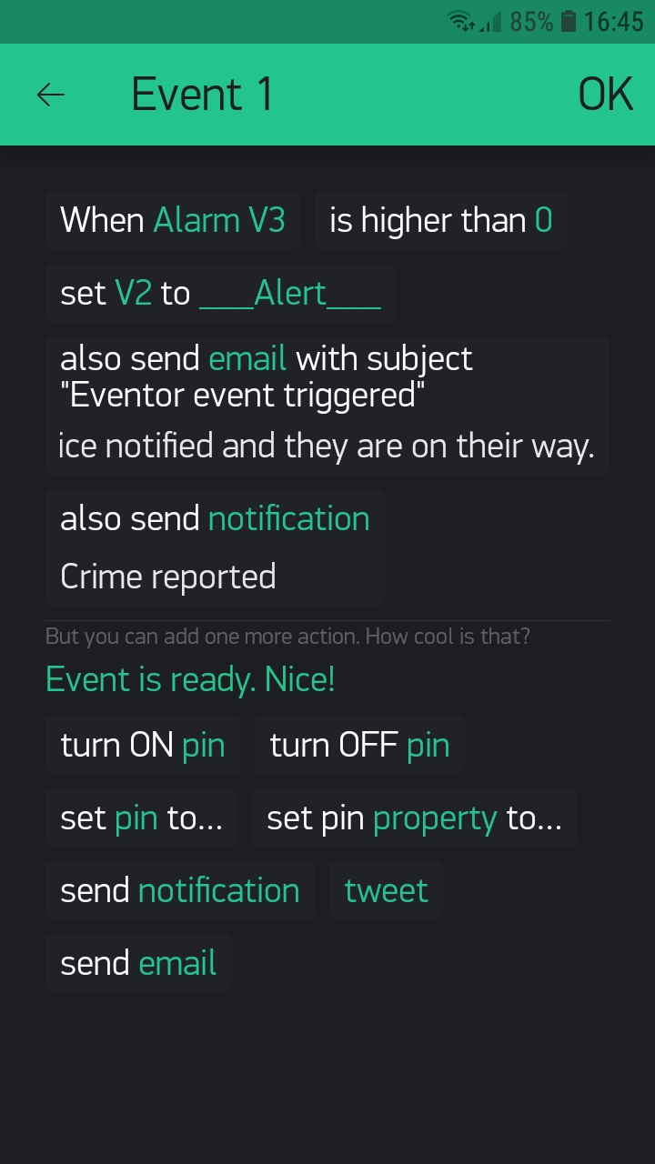

Android.
V2 is Terminal
V3 is proximity widget named “Alarm”.
So the Eventor below looks for proximity to go high and sends an email and PUSH message. Plus sends some text to the terminal, all without an MCU.
In the screenshot above the word “Police” is truncated to “ice”.
