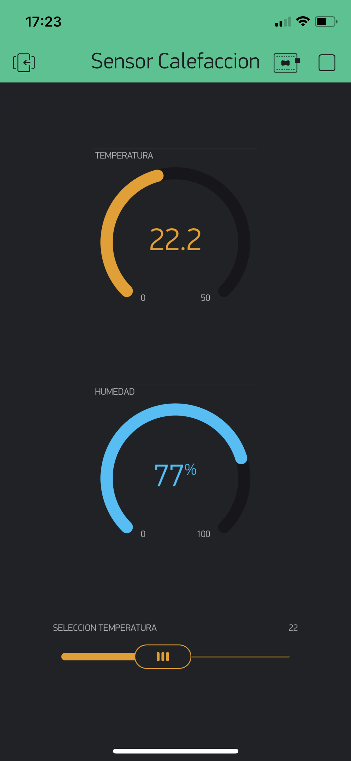

Hi guys, I’m trying to develop a simple app with an ESP8266 that will send me humidity and temperature information with a DHT11.
That, I got it. But older I want to add a slider to enter a temperature range where a radiator is turned on or off (that is, a thermostat) to simulate the radiator and I put a led on the D2 output (GPIO 04), I am trying to get my slider to send information to my code and with an “if” the radiator is turned off or on according to the set temperature.
Then I put the code I have …

I can’t get it to work properly, when I move the slider it lights up once and then it never works again

One last thing, now to finish, how can I put a manual on / off button and that it commands (or has priority) over the slider … ??
