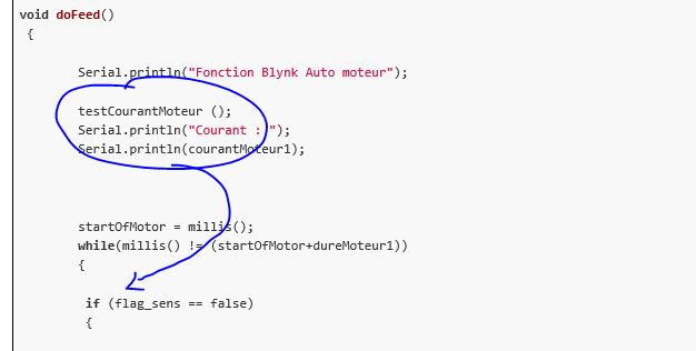

maybe change the test into the while ?
Capture
I would deffinitely avoid such a way of timing tasks. And what if device will be busy during this single, one millisecond?? You should use the ‘<’ instead of ‘!=’ Then the loop will be executed as long as the current time is less than the designated time, but will not have to point exactly that time.
In your code this shouldn’t be a problem, as loop is closed and has very little to do, but what if some more time demanding task would step in?
good point ! i change that !
thanks.
Why is there a space between testCourantMoteur and ():? That should give a nice error…
Anyway, another hint. If you turn everything into English it’s much more understandable for everyone here to see what your program is doing. It’s not a very big thing, but it could lead to better solutions :slight_smile:
Just though flag_sens_canBeChanged && courantMoteur1 would be compared before the next statement
it seems to be compile with or without space, but i change it. :wink:
you are right for language… the next projet will be in English (i’m french)
thanks for your help :wink:
Mmmmm what do you meen exaclty ? inverse void testCourantMoteur () and BLYNK_WRITE(V0) maybe ?
What you mean by this? Can you clarify?
